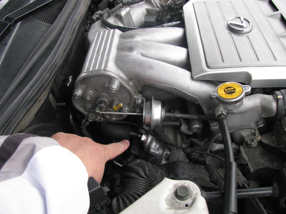

I recently bought a replacement PCV valve for my 1999 Lexus ES300. The only problem is I have not been able to find the valve location underneath the hood of car.
Anyone know where its locate? Words of advice would be appreciated, a digital picture would be greatly appreciated.

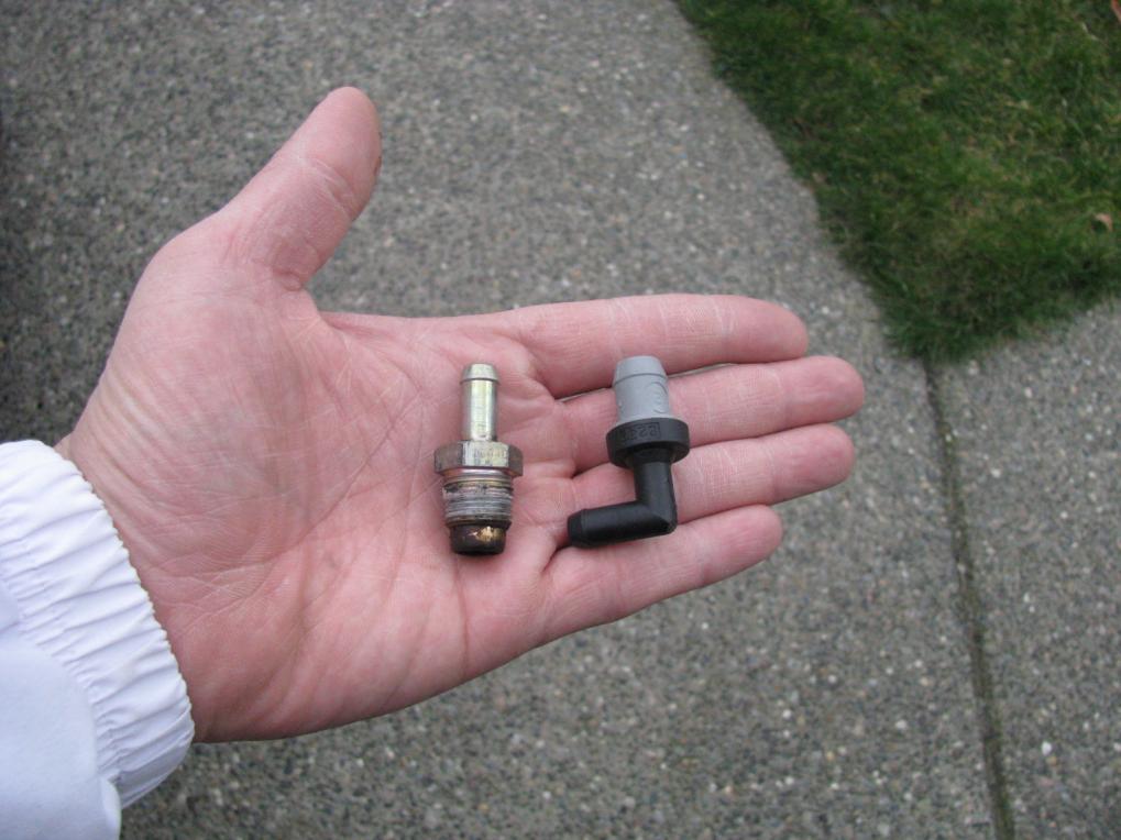

Found the valve myself.
Here is the information that others will need to solve this mystery.
What you really need to know is that if your engine has been desludged the L shaped plastic PCV valve would have been REPLACED with the metallic, straight screw in PCV valve first introduced in 2002.
